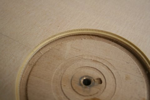

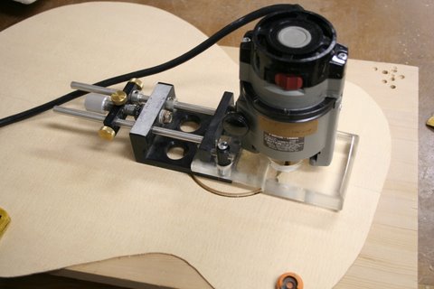

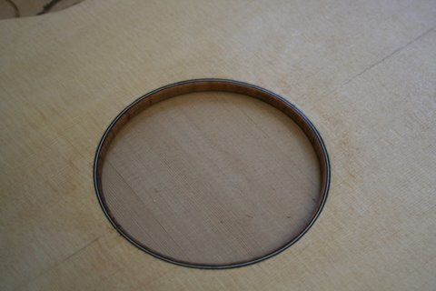

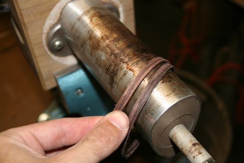

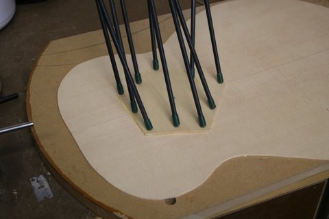

Anyway, here's a little how-to.
This isn't rocket surgery.
I start out with a soundhole patch. .100" thick cross grained spruce.
Soundhole gets cut with whatever purfling scheme is needed. This is done with a router on a circle cutter and just micro adjusted for the purfling shelf.
Then the binding is bent on a pipe to a 4" circle.
All is put into place and "clamped" with tape until the glue dries. Finished product.
Hope this helps. Paul

Terry, nice simple circle jig.

Paul, thanks for the great illustration/tutorial. Dumb question -- why do you reinforce with a cross grain spruce patch?

The soundhole patch serves two purposes: 1)it strengthens the fragile soundhole area. A lot of people make small finger braces that do pretty much the same thing but this in easier IMHO. And 2) it gives me the desired thickness of the soundhole to make a full 1/4" binding. I like it when people see it, stick their fingers in the soundhole and think that I've used a 1/4" top on the guitar. Yeah, that would work well!?!
You're "ring" binding would work fine. I've tried that but like the look of binding in that the all of the grain runs in the same circular direction, if that makes sense. Different strokes but my personal taste is for true binding.
